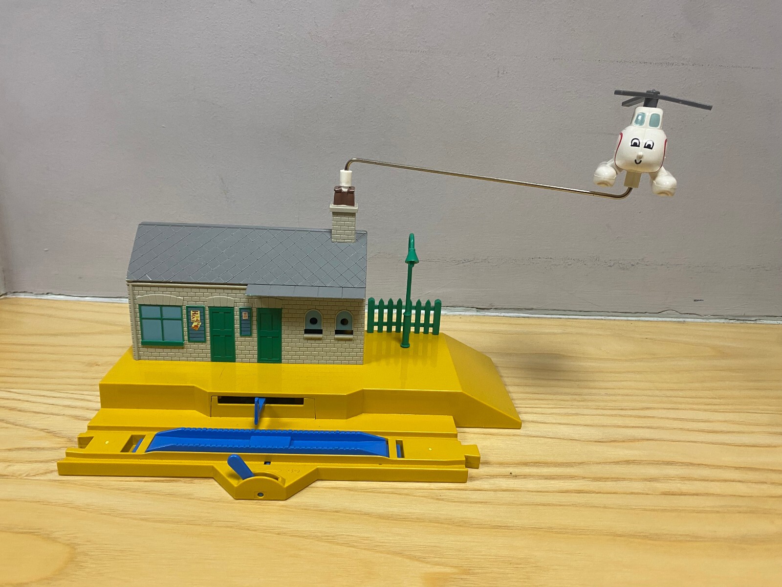

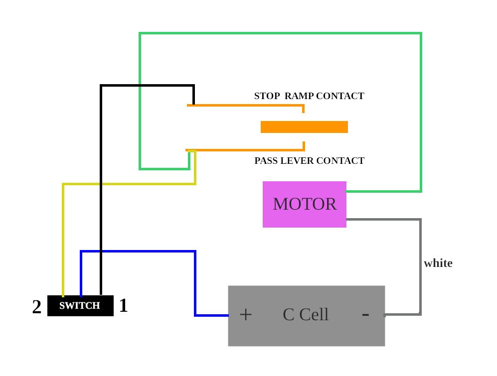

I recently received one of these that wasn’t working. When I dismantled it I found that it needed re-wiring. The diagram below explains how the wiring should be organised, and may be of some use to anyone else who needs to repair one.
There are three switches, the first is operated by the button on the platform beside the station house, the second is operated by the stop-rail ramp being raised, and the third is operated by a vehicle parked on the stop-rail pushing on the pass-lever that protrudes from the side of the platform.
When the button switch is in position 2 the motor is live and the arm with Harold on it rotates regardless of the position of the other two switches. When the button switch is in position 1 the motor only rotates when the stop-rail ramp is raised AND the pass lever is pushed to one side or the other by a locomotive that is parked on the stop-rail ramp.
