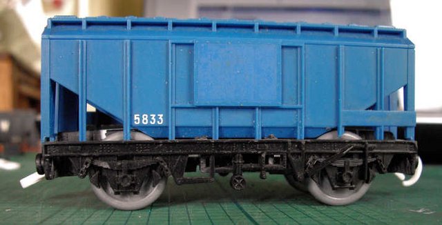

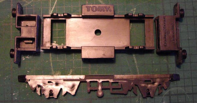

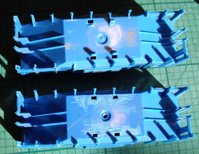

The first picture shows a Tomy Annie/Clarabel chassis above and the Hornby Chassis below.

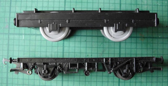

And from the side. The Hornby chassis is a bit longer, and the axles are further apart. I want to use the detailed Hornby side plates, so the Tomy chassis needs to be lengthened, and the axle supports need to be moved apart.

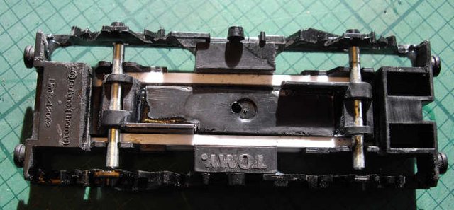

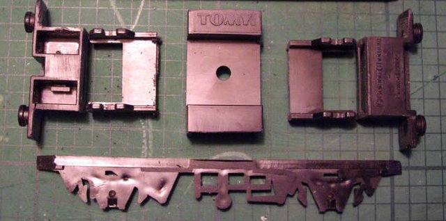

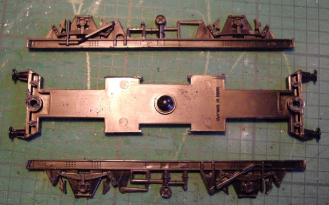

The first cut (is the deepest). Sides removed from the Tomy chassis. I want to keep the end buffer/coupling sections.

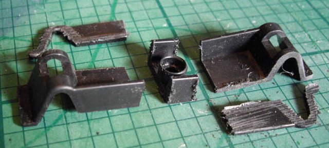

Sides removed from the Hornby chassis, I cut it like this so as not to destroy the buffers - they might come in useful sometime.

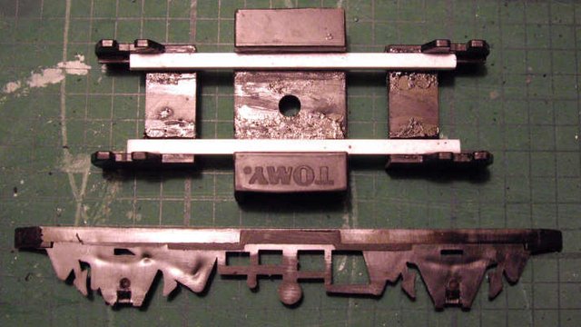

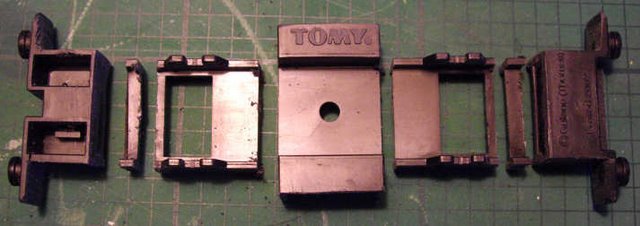

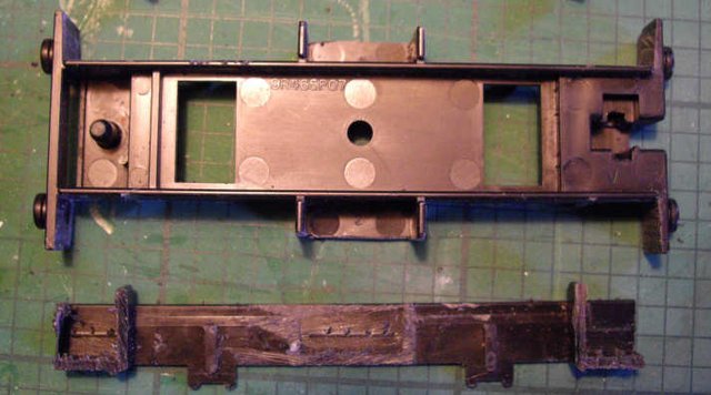

Tomy buffer/coupling sections separated and spaced to about the same length as the Hornby side plates.
Tomy axle support sections separated, and a slice removed from each end so that they can be moved closer to the buffer/coupling sections....
...like this.

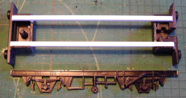

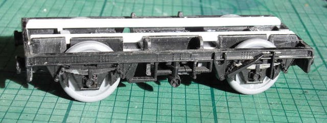

Lengths of square section styrene superglued to the undersides of the three middle sections of Tomy chassis to give the correct separation of the axles.
More styrene struts glued to the end sections to give a length equal to the Hornby side plates.

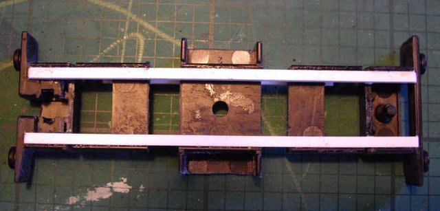

Everything coming together nicely.
And from the side.

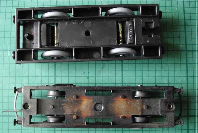

The original axle retaining piece is now too short, and also too wide - more cuts.
The two ends of the axle retaining piece in position. (The sides have been glued on too - sorry I forgot to photograph that step. The corner joints are reinforced with fillets of Araldite 2-part epoxy.)
