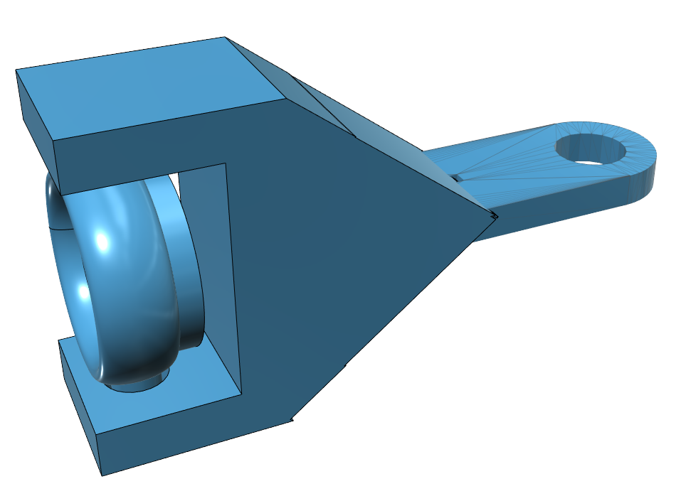

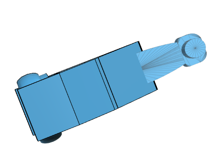

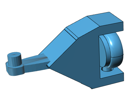

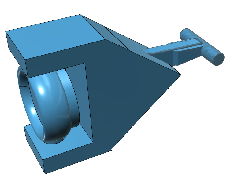

Rather than buy these trains just to harvest the magnetic couplings how about these custom designed ones?
I've designed them so that you can glue 10mm diameter circular magnets to the disc part and this will then swivel left and right in the frame, thus enabling the coaches to take corners better without straining the magnetic connection too much.
So far I've made 3 variations on the design with 3 different Tomy connection types which should cover most engines and rolling stock (see pictures below);
Type 1
Type 2
Type 3
