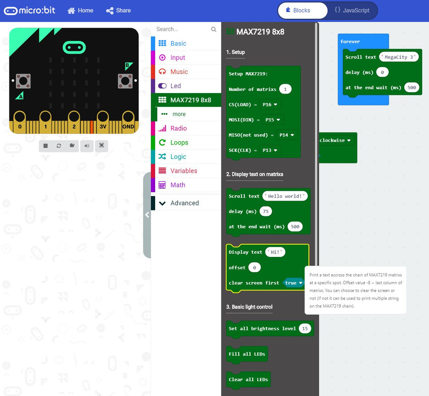

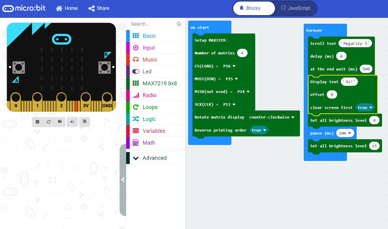

The last thing you need for your brain is software to control and send your message to the display.
The MakeCode editor which is an online web based code editor for your Micro:Bit allows you to search for public extensions. Search for one called MAX7219. This extension knows how to control the MAX7219 chip on your display. It's designed for kids so it's really simple to use in the editor with drag and drop. Read more instructions on how to use the software extension here:
https://github.com/alankrantas/pxt-MAX7219_8x8
