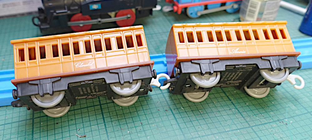

The coaches in the July 2020 Motorized Thomas, Annie & Clarabel (GHK82) are arguably the best looking of any Revolution/Motorized rolling stock to date. I'm thinking they have great potential as narrow-gauge coaches, being shorter than any previous coaches in any range, while still nicely detailed (rather than merely vans with stickers on).
It's curious that they made the faces almost the same, but not exactly the same. Only their mother could really tell them apart.
Before they're allowed on any real railway however, something will clearly have to be done about replacing those 'wheels' with actual wheels. You can't just make a straight replacement because the difference in axle diameter (5.5mm vs. 3mm) makes the fit way too sloppy, and because the difference in wheel diameter (21mm vs. 22mm) means there is insufficient clearance.

Note that the replacement wheels are positioned with the small raised boss on the outside, the larger and flatter disc on the inside, as shown in the two pictures above, this gives the best lateral alignment with the slots in the black chassis-plate.
