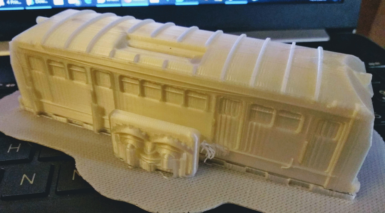

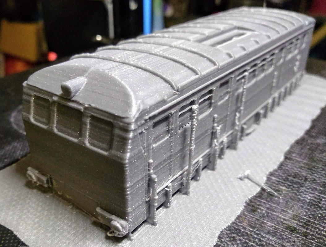

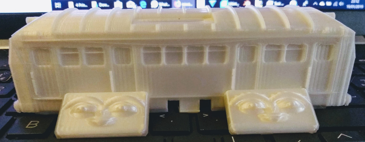

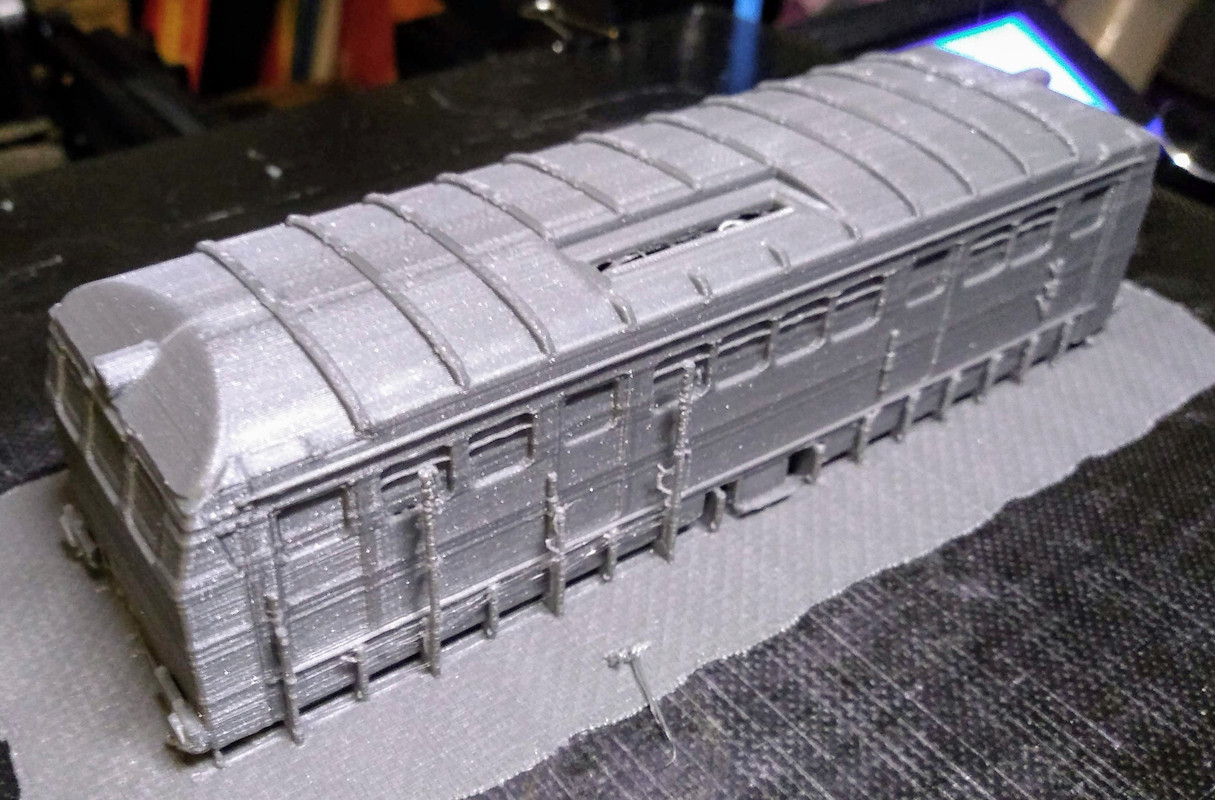

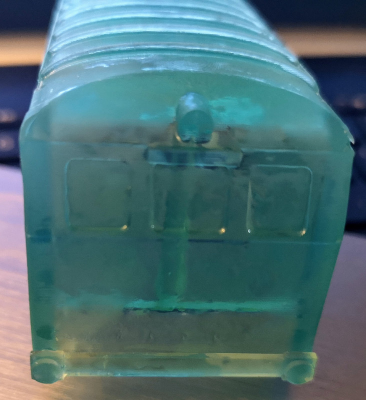

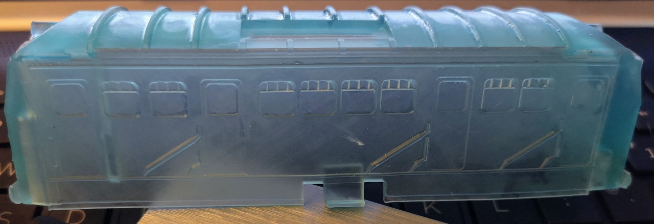

The resin prints have a couple of advantages, firstly the resolution is massively higher so if you are printing small models you can get more detail in them. Secondly they are generally speaking stronger as you don't have heat bonded layers which can 'de-laminate' and cause weak points on a model, this is one reason with an FDM printer you need to be careful how you orientate the model when printing it. Thirdly they print quicker than an FDM printer as you print an entire layer with each operation (taking a few seconds) whereas on an FDM printer it has to draw the layer line by line which can take quite some time if the model is large and has large printed areas on a particular layer.
The downside to resin prints I've found is that although they are stronger if printed to the same thickness as an FDM printer model they can also be fairly brittle and will break easier if bent too far. There are special resins available which claim to offer either greater strength or greater flexibility, but they often cost considerably more and I've not yet really investigated those.
The biggest advantages to FDM printers is that they have much larger build areas so can make physically bigger models in one piece whereas on a resin printer you would have to print a similar sized model in multiple pieces and join them together somehow. Secondly the cost of filament is generally cheaper for the same size model, so say a 1" cube in resin may well cost several times more than a 1" FDM cube. But of course using hollowing techniques and infill (think of a hex structure as in a bee hive) you can make an apparent solid model with less materials.
