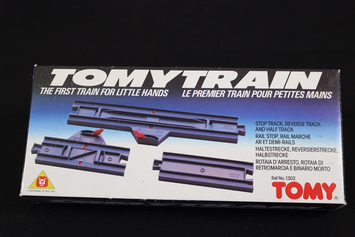

Hey, that's my video! I bought a second round-trip EF66 recently as well as some old 1960s Y turnouts that automatically send a train off to the left and I have always wanted to use the "automatic" R-15 crossover switch to make a shunting yard. I used all TomyTrains reversers, which is indeed why they are dark blue, but interestingly while the original plarail switched reverser was actually a full length light blue track like a stop rail the original Plarail static reversers (which are also a full length straight rail in TomyTrains) were in dark blue plastic.

This took many, many tries to get working properly - Plarail cars do not really like to be pushed and both of the "automatic" switches I used rely on "tricks" of the molding to operate which the lighter, unpowered carriages do not always interact with the same way the weighty power cars do. Getting a Plarail car to collide with another without the couplers or bodies fouling and causing a derailment, especially when getting pushed across tricky track molding, was tough and the train also reacts differently with cars when hitting them from the slightly pointed front and the straight coupling bar sticking out in the back. When you see the siding that the mail cars get shunted to shift that was me adding more track to the end of the line because I had never actually gotten it to work that far before and realised the siding needed to be longer to hold all three and still let the locomotive hit the reverser. I used both the TomyTrains static full length reversers as well as the switchable half straight ones. TomyTrains is built around a similar reversing concept, although the loading gauge was larger than Plarail and it used magnetic couplers (there were also magnetic couplers sold as Plarail accessories, and I have played with those and my other Round-Trip EF66 before).
