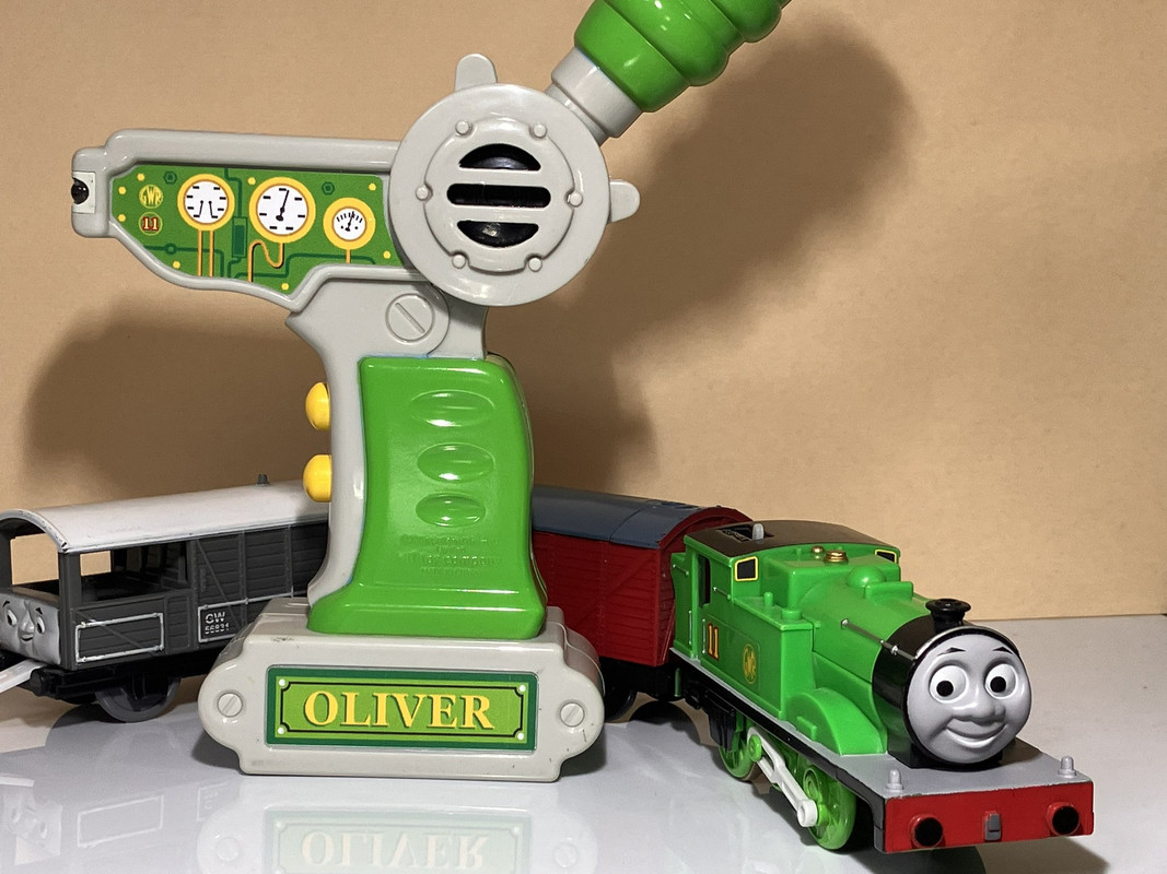

Tomynewacoliver from... guess where, whose previous projects include a front wheel drive Oliver, HiT/early FP style RC Oliver (complete with whistle), Power Rails RC Hurricane and an improved 3 Speed RC Gordon, made an outstanding TnA Oliver using components from four different items: a TnA Thomas (track sensor), an early FP Talking Thomas (3x AAA+speaker truck), a Japanese Talking Edward (sound equipped Mail Coach) and a My First Thomas Talking Oliver (sound board and motion sensor). Here are the photos and info he provided on how it was done.

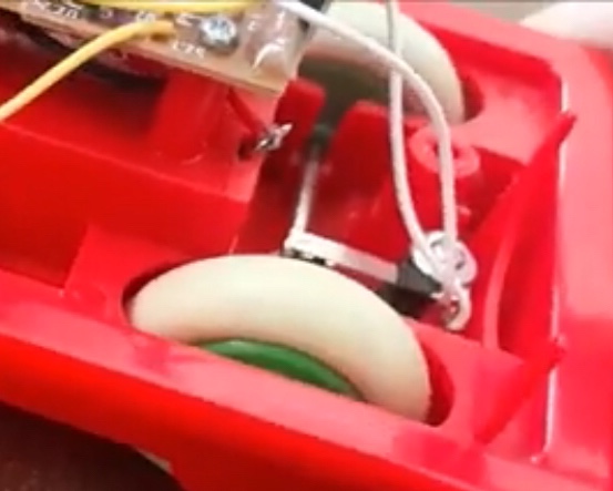

The small red bit is the mechanical track sensor from the TnA Thomas. It was hard for him to mount the sensor beneath Oliver, so it had to be located in the first battery truck. He only holds the actual circuit board for it, along with weights for increased torque; the permanent electronic trucks are too heavy when fully loaded.
The sound truck from Edward had its sound board replaced with the one from the MFT Oliver. Two corners had to be cut down for it to fit. Unlike official TnA engines, which don't say anything while moving unless the track sensor is triggered (depending on how many presses), both it and the buttons on the sound truck are wired in parallel to the pads where Oliver's button was. That allows the phrases to be heard without having to rely on TnA track pieces. The MFT board is set up to detect one press, meaning regular track will also trigger the sensor if loosely connected. That range uses a wiper on the rear axle to detect motion and play the chuffing/other engine sound, so he made sure to wire that to the wheels that triggered the phrases and sounds for Edward. Demonstration videos: running, sound only
Due to use of the sensor's original circuit board, he knows how to react to the codes that tell the motor to stop, accelerate or slow down. I incorrectly thought it made him stop for a few seconds no matter what code he was on, which isn't the case. However, I could see him being difficult to store compared to anything else with a wired battery holder (that I know of). Regardless, it's a really well made and ambitious mod I thought would never be possible and I admire how he was able to work it out.
