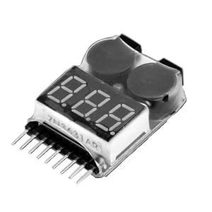

Then the voltage alarm, it needs to be suitable for the battery, if you use a 1s type like above you need a compatible battery alarm, this will alarm (usually audibly) when the battery needs recharging,
