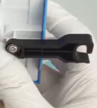

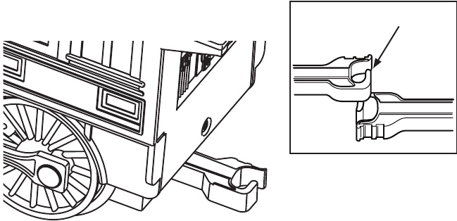

This knuckle coupler wouldn't actually work due to its incorrect shape, so it eventually wasn't fitted. I only made it to get an idea of what size the final one(s) should be. Lionel's toy grade Ready to Play trains have a design that "looks" like a knuckle coupler, without the moving parts. They only slot into each other from the top/bottom, but are still perfectly functional and don't cause stalling/derailments. Even a few other scratchbuilders like BumBin Creative have figured out how to make them for Indonesian/Indian rolling stock and other countries that use them in real life.

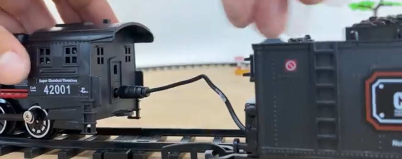

I then made a placeholder coupling for it to pull the Union Express coach. It has four wheels, no floor and weighs only 67 grams, so I knew the tender would have no trouble pulling it while also pushing the loco (which weighs 79 by itself). My own coaches are planned to have actual bogies and thus more friction, so I'm hoping the same could be said for them.
Having examined the Ready to Play coupler by following manual illustrations, I ended up drawing a G shape on cardboard and gluing a flexible strip over it. I then repeated the process and made another one to try the design, and they actually stay together very well; the only way to separate them is by lifting/pushing one out of the other. Both heads were glued to arms made of four sticks each with a plastic tube ring at the other end, and one was temporarily fitted to the tender.
