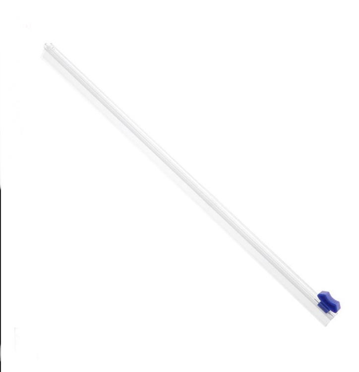

Rather than two four-wheeled dollies on their own tracks, it now rests on rectangular runners (skids) that slide along cling film cutter rails. I previously tried this technique when I wasn't sure how I could motorise it, hence why they were glued to the base before I took it out again. One might think the pieces of paper at the bottom would increase friction, but they were mainly added to extend the runners and make the platform a little more stable. Unlike the previous runners, they have triangular supports to keep them from falling off/bending too easily.

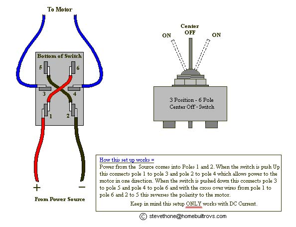

Since I (initially) wanted to power and control the unit from the base, the extension was sized to fit a 2x AA pack. Holes were added to guide the wires under the track and out the other side so it wouldn't run over them, and also to keep them out of view. My only three-way switch had three prongs with unused holes on the other side, and I had no good way to make new ones to achieve this circuit. After trying to find a convenient spot to operate it from, the power wires were connected to the same "poor man's" polarity reverser I originally used: a dial with two live rods that make contact with three nails wired to each other and the motor. Main problem with this method was the long wires couldn't be hidden or anchored since they had to move with the platform without getting stuck. A top view of the transfer table with the controller wired to it:

Like the motorised engines I've built for the UE track with this gearbox, it could also run on a piece of normal track (which might help it grip better thanks to the teeth in its rails). If I had the unique DU from the Forward/Reverse Thomas, it would've surely been one of the best ways to power it; apart from its torque, it could also be wired with the battery(ies) next to it and the track in front unlike a Flat or Chassis Based DU. I should hopefully be able to get a proper six prong three-way switch so I could rebuild it with on board power and other improvements.
